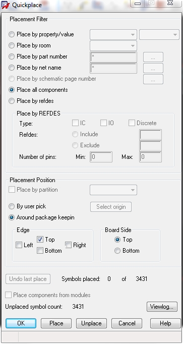

Hi All,
In one of our new design, due to large number of parts, we would like to place the parts as "Place by schematic page number". But in our tool the option is disabled. If anyone knows how to enable it, kindly help us.
Attached a screen shot for reference. Using Allegro PCB design L v16.01
Thanks,
Shiva.

    Thanks all for your inputs.
     At Nayyierwajih, we are using Orcad for schematics. As oldmouldy told, we need to upgrade our tool to v16.5 or later to get this option enabled.
