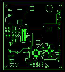

    I need your in-depth help in this issue. Because, I fully halted here. I am facing much problem in understanding the procedure to create and view each layer separately. I can able to create the Artwork file. But when I view in PCB Designer Window, It shows all PADS as unfilled. Also, there are huge number of DRC errors. Full Board filled with DRC errors red symbol. I did as per your suggestion, but still unfilled PADS only shown but NOT filled.
    Procedure I followed:
    I did only for simple TOP (Etch) Layer only.
    Manufacture -> Artwork -> Select TOP in popup window -> Added Board Line outline to the exsiting (default) Classes/Sub-Classes.
    So, under TOP menu, there are 4 Classes/Sub-Classes.
    1. Board Geometry/Outline
    2. Etch/Top
    3. Pin/Top
    4. Via Class/Top
    I use all default settings. Create "Apertures...". Then "Create Artwork". Artwork Created successfully.
    This is the sequence I used to create Artwork file.
    Viewing Gerber RS274X in PCB Designer Editor.
    Case 1:
    When I import the Artfile TOP.art to existing board window (i.e Place the imported Artfile Top.art next to exsiting .brd file),
    File -> import -> Artwork,Top.art file shown with unfilled PADS. No DRC error there.

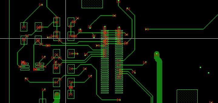

    Case 2:
    File -> New -> Blank Board named test.brd
    When I import the Artfile TOP.art to test.brd,
    File -> import -> Artwork,Top.art file shown with unfilled PADS. Huge number of DRC errors there.
    I tried to change the Display -> Color/Visibility -> Display -> Global Transparency &  Shapes Transparency. Change to 100% to Solid.
    Still unfilled PADS but not filled. But, if I use "Shape" Menu -> press "Change Shape Type" -> PADS on selected rectangle area changed to filled. But, could not able to use this option for full board.
    Any suggestion pl?
    Thanks

    SOFTLAB over 12 years ago
     I uploaded the image file [for Case 2: that I mentioned above] separately for your reference. Full page filled with DRC Errors. Any idea pl?
    thanks
