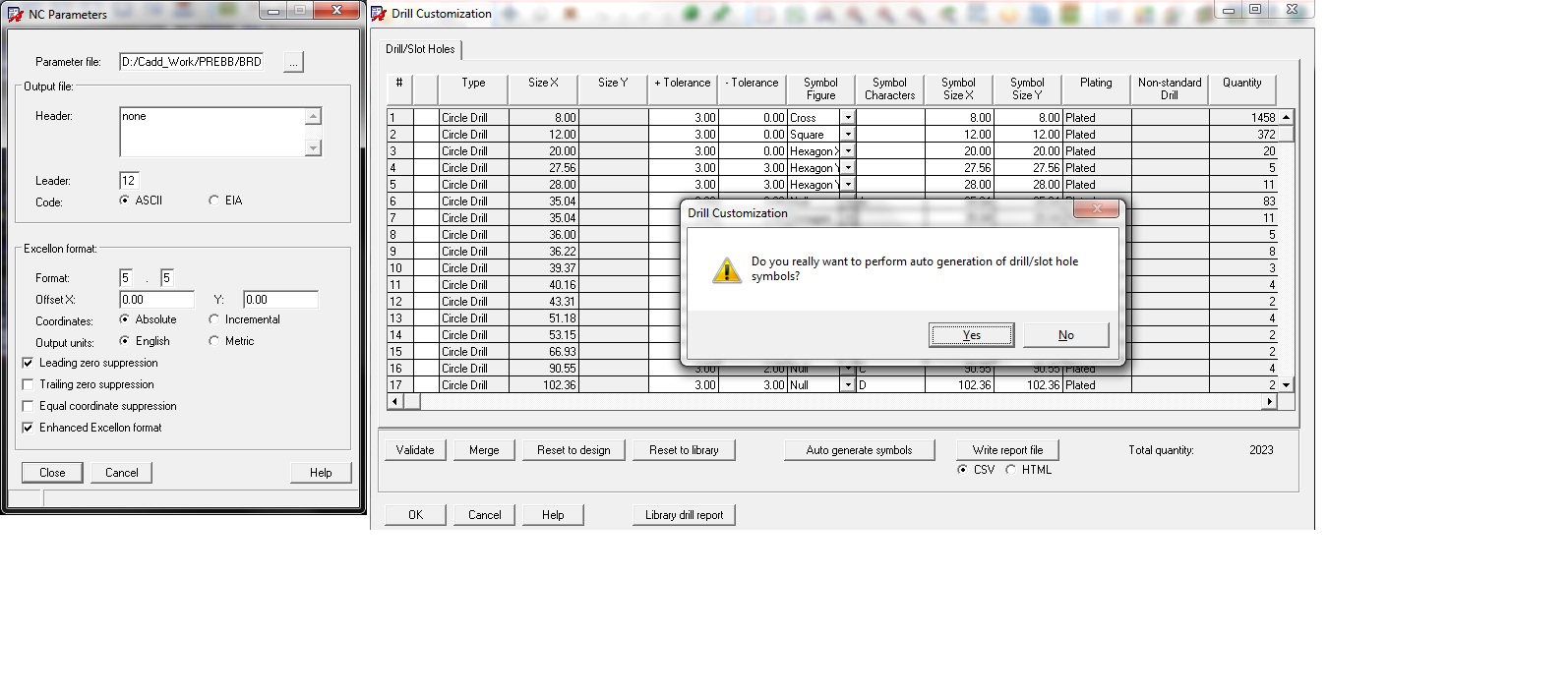

I'm having problems getting my board made. We have a small machine on campus capable of printing a board (I think only 1 sided), but the technician is telling me that the drill file generated by Allegro are recognized by the machine. Has anyone else had a problem with Allegro Drill files? If so what can I do to fix this?
 The board I need to make is single layered. Attached is an image of the NC Drill window. Is there anything that is wrong here?

    Have you  followed these steps while generating NC drill
    1)Set NC parameters (manufactue>nc>nc parameter)
    2) Drill customization (manufacture>NC>Drill Customization)
    3)NC Drill ( file.drl)
    4)If you have slot in the desing generate NC route file too.
     Refer attached image , hope this may help you
