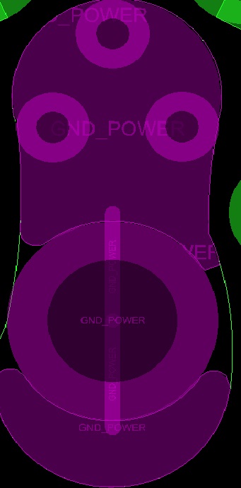

I want to creat a whole shape that covered all the 3 vias and one through-hole pad,  i set the constrain , the same net (shape to all is 0) setting is 0, but why i the greater throught hole can not connected with shape like others? Still has clearance.
Could someone tell me how to change the setting? Thanks,

     Set the Global Dynamic Shape Parameters "thru pins" to be Full contact. That setting can be found in the Design Prameter Editor window under the Dybamic Shape tab.
    --Skip
