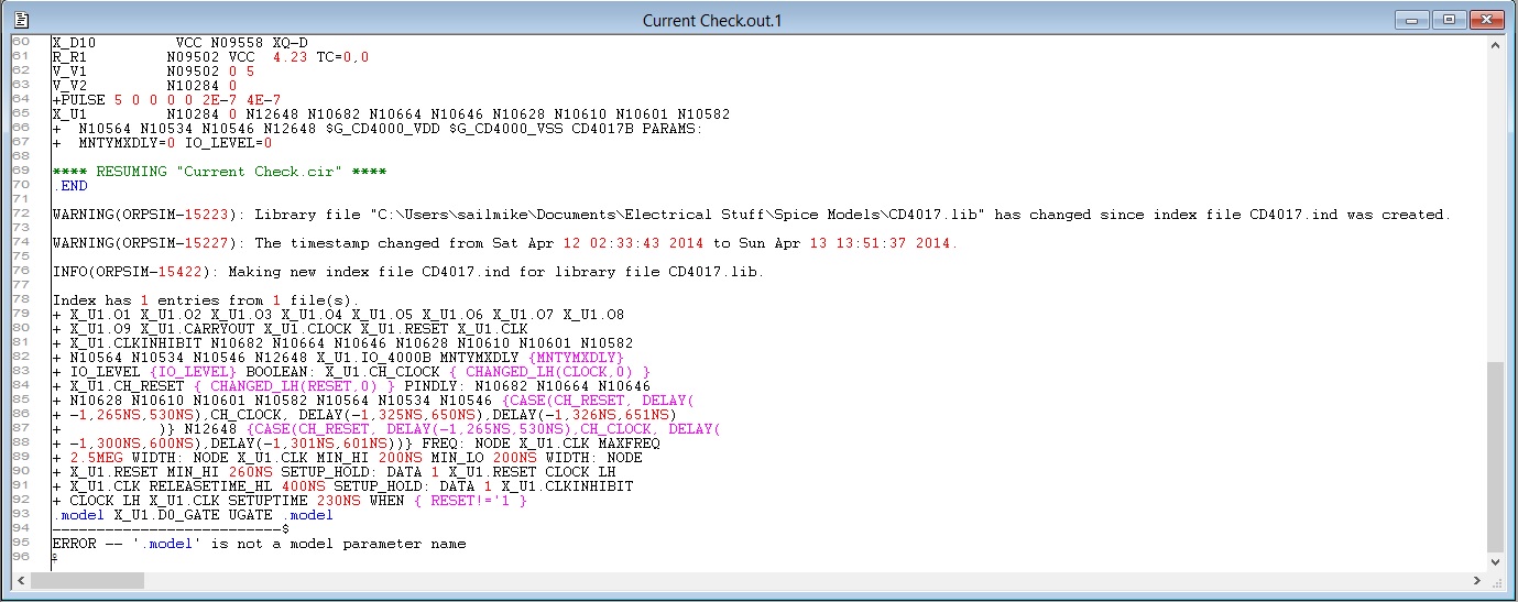

 I found the following model code for a CD4017B decade counter, but it doesn't work. I'm getting an error as seen in the attachment. The model code I found is:

I think it's missing some lines. Shouldn't there be a line starting with ".model"?
Thanks,
Mike

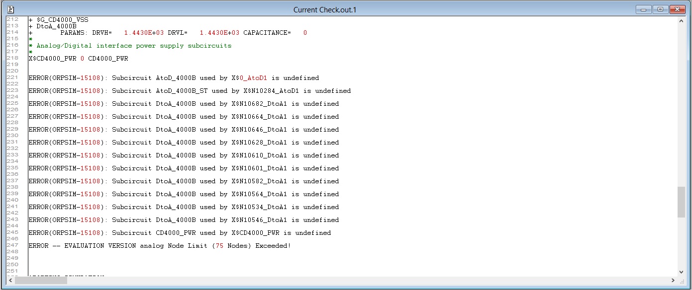

     That solved one problem and added a new one as seen in the screenshot I attached here. The new coding:

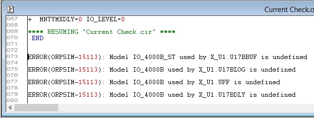

    Sailmike over 11 years ago
