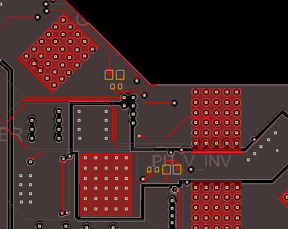

Thsi poat is re-visited because I couldn't make it work the last time and had to kluge my way through my design. My situation is that I have a FET with a large pin. I need to add an array of 30(6x5) vias in the symbopl on that large pin to use as a thermal array. There was several suggestions but I couldn't get these to work and had to move on. I'm back asking for advise. Any hints will be helpful as I am am coming up on schedule.I'll attach a screen shot that will show the problem.

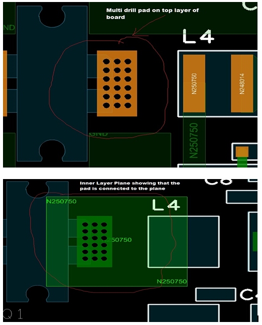

    To answer your questions.
    The multi Drill option is used in a pad when more than one drill hole is needed. "Typical use is for a regulator tab" to remove heat to a plane.
    In a multi drill pad "There are no thermal vias" It is simply one pad with holes in it.
    Net connectivity is based on pin info in Allegro. So if the pin has a net name of ground and that particular pin has a multi drill padstack attached to it then it "Will connect to a ground plane or shape or any net that is named ground"
    In a thermal pad there is no reason to tent the holes, that dont make sense to me. I can see dong that in vias but in this particular instance no tenting is needed.
    Lastly over on the schematic side your multi drill padstack that is really only "1 Pin on a pcb footprint" can be represented as 1 pin in the schematic symbol.
