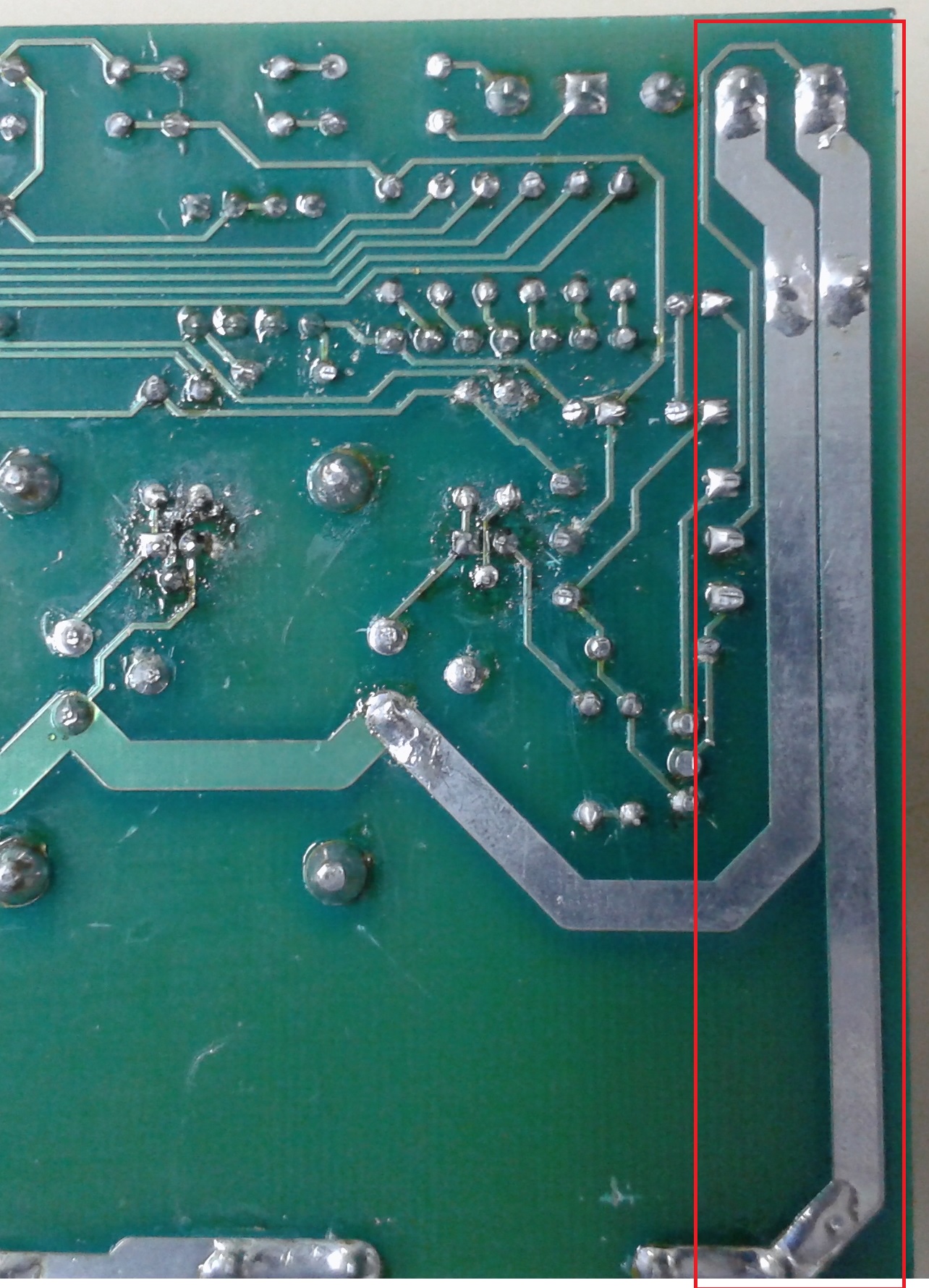

I use the PCB Editor v16.5 and want to leave the trail BOTTOM totally exposed, because when I mount the board, I want to fill the BOTTOM trail with solder to strengthen the capacity of current conduction. Dry on a sample photo attached

     Add a line of the same thickness as teh track on the layer BOARD GEOMETRY / SOLDRMASK_BOTTOM and then follow the same path as the track. Then make sure this layer is included in your Gerber Output for Soldermask Bottom.

    No OrCAD Layout eu roteio a camada SMBOT (Soldermask bottom), mas no PCB Editor não sei como adcionar esse layer para ser roteado.

     Use Add - Line, then Options (fold out menu on the right hand side) set the class, subclass and width as described above and then add the line over the existing track.

     Thank you helped me a lot, but I thought I would have to route the layer as I did in OrCAD Layout.

     You still need to Route the connection on the Etch/Top or Bottom or whatever layer but if you want to expose the soldermask you need to draw that using lines. Your creating a layer that will be used to create the gerber file for soldermask, the same way it would be done using layout.
