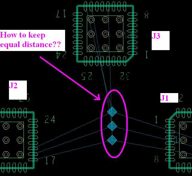

Hi everyone,
i my design i address 0-16 are travelling from J1,J2 and J3 i need to route equal distance from my T point How to keep T-point equal distance.Is i need to measure the signal from T-point please help any one for this post

    steve over 12 years ago
     Locate the net and make a Pin Pair of T-Point to each J* then create a match group of the Pin Pairs to match within a certain length. There's a video on YouTube, search for Parsyseda and on that channel search for T-Points

    kabalee over 12 years ago
    Hi i did the pin pair in electrical constraint-->relative propagation i assigned Pin Pair From T-point to J1 and T-point to J2 and T-point to J3 i did length matching also let me know is it possible to set the Pin pair and corresponding length matching is possible right ??
    how to set the T-point in signal explorer ??
     Watch the Video, the detail is all there. Select a net in Constraint Manager - Electrical - Relative Prop Delay, then RMB - Create - Pin Pair....
