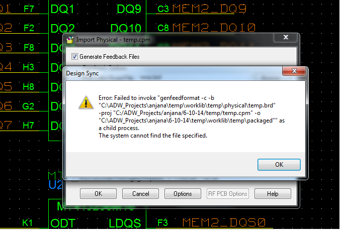

    KARPCB over 11 years ago
     Thanks a lot chad. in this part file RESET_n is mismatched between symbol and part file. i modified and solve the problem.
    In the same part file i have to enable the swap pin also and import to board file then  swap the pin as per my requirment. after swapping i was trying to backannotate but its not working. its shows some error.please help me.
