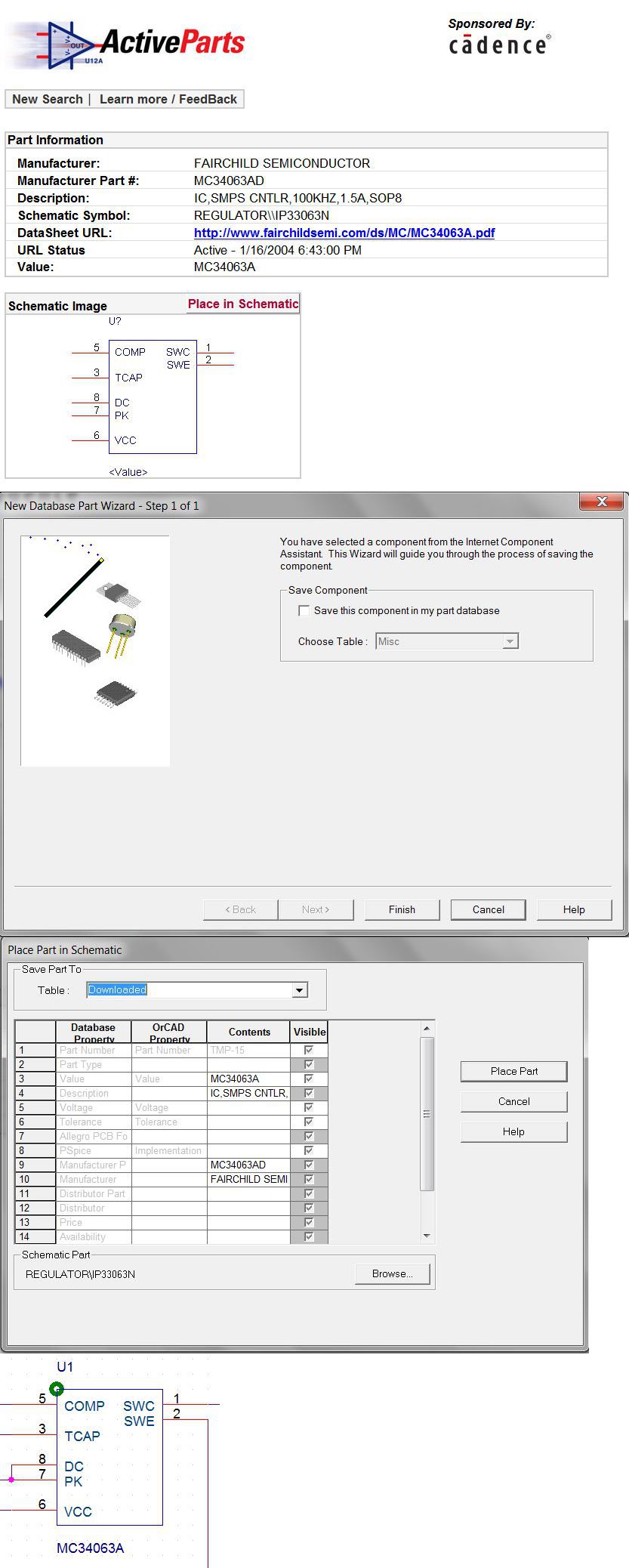

 I've downloaded the Fairchild component "MC34063A / MC33063A SMPS Controller" from ActiveParts. It adds to the schematic, however when simulating with a Transient analysis prompts the error, and apparently the component was ignored.
The following 1 points have been identified as net connectivity change points from the last operation
(4.10, 1.50)
Creating PSpice Netlist
Writing PSpice Flat Netlist C:\Users\Miguel\Documents\OrCAD Projects\energizer-PSpiceFiles\SCHEMATIC1\SCHEMATIC1.net
WARNING [NET0093]   No PSpiceTemplate for U1, ignoring
PSpice netlist generation complete

    That is likely correct. You will need to get a SPICE model for the part from the part vendor, if one is available, associate it with the schematic part and tell the simulator where to find the model within your libraries to get the simulation to run. Active parts holds schematic symbols and associated properties.
