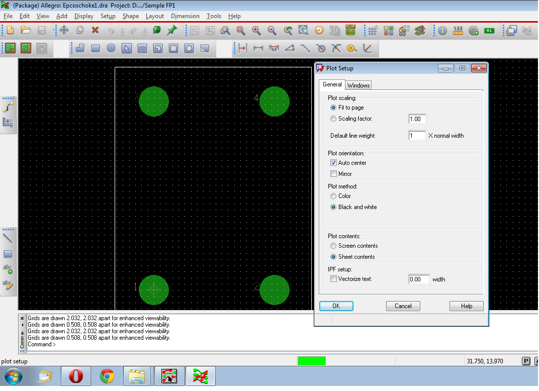

After Foot print creation, (.dra) file priniting problem occurs?
Dhamodharann
Dhamodharann over 11 years ago
Hi..
I had created an sample epcos inductor with the specifications provided in data sheet. Then after creation of the footprint, i want to took the print in A4 sheet and then i have to place the component on the tooked print A4 sheet and see the component is matching with the created footprint.
So whenever i had too the print means the the file get printed, then component placed on the sheet is get varied, what i had created footrpint. So my problem is been get facing is i want to took the print means what are the settings to be given in the plot option.
So any one provide the solution for the plot options(Setup Options) in the footprint creation window. The image is attached.

    If you want a scaled plot then use Scaling Factor of 1. If it's Fit to Page it will fit the symbol to the page so could be any scale required......
