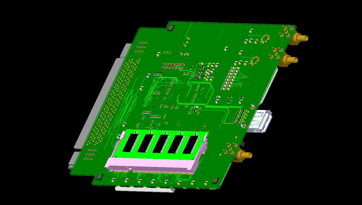

     You can import a STEP model of another board but currently you cannot clash detect between the two (unless it's just a visual check). The steps are:- Create a STEP model of the other board. Then open the board you wish to assemble it with and use Setup - Step Package Mapping, then click on Add Mech, specify a name ensuring you leave the STEP3D_MECH_ so call it STEP3D_MECH_DAUGHTERCARD (for example). Once added you will now be able to select the STEP3D_MECH_DAUGHTERCARD in the top half of the GUI and slect the actual STEP model to map to it. Position it using the Mapping options for X,Y and Z plus rotations below. The STEP mpdel will now be mapped similar to the attached view.

    catuas over 11 years ago
    Hi Steve,
    Many thanks. I will try that.
    Regards.
