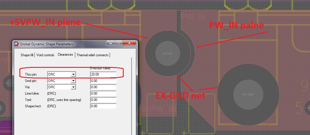

I have defined circle as Thermal Relief for all layers of my pads. Below are some questions regarding shape drawing in various layaers:
1- Thermal Relief doesn't work for power planes while it works for signal, Top & Bottom Layers. I see that it only uses a zero length cross to connect pad to polygone or shape in power planes (Figure 1)

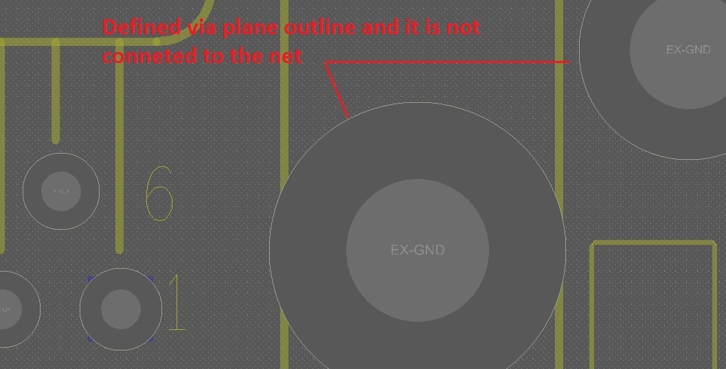

    Thank you for your answer. Unfortunately, I still have some problems:
    1- If I define plane outline shape, it'll be always "Solid " not connected to pad, I need to change it to Dynamic copper. Below link shows it:
     https://drive.google.com/file/d/0BzS3_lT7y4tEaUI0MW4wRkxkZVk/edit?usp=sharing
    2- Even after changing shape to Dynamic copper it is still connected with 0 width to pad. Although I have defined other value for min line width. Furthermore, it connects to the pad with correct width when I draw it in Top, Sig or Bottom Layers. Only Power planes!.
     https://drive.google.com/file/d/0BzS3_lT7y4tEWVpwckJoLUg3YU0/edit?usp=sharing

    I don't see why shape clearance doesn't affect pins inside the shape?!. Below picture shows that just one of shapes of power plane is affected by shape clearance?!
