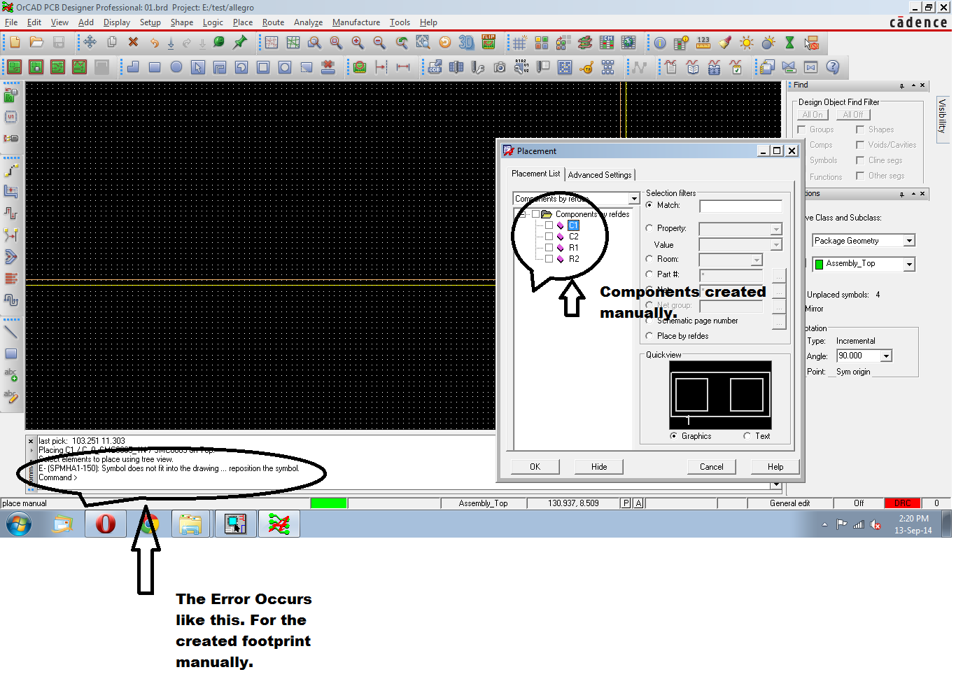

Hi.. I had created the footprint with specifications with what ever in data-sheet provided. When i am try to place in manually or place all components or place with room outline, the components is not get placed and enable in board. It's urgent. so any solutions please.

    The message is that the symbol will not fit into the drawing, check the units Setup>Design Parameters, Design tab, pick a standard sheet size large enough for the design, typically A, or A4, should be OK but you might need a larger sheet. Open the symbols up and check that the origin, 0:0, is within the symbol, typically, body centre for surface mount and pin 1 for through hole, adjust the symbol origin if it is not within the symbol.
