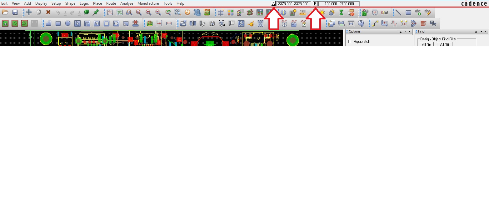

There is a way to display Absolute and Relative coordinates together in OrCAD PCB Designer Professional ?
In most cases when i move a symbol or other object, i need to know the absolute coordinates, but also the relative distance from origin of move. This is much important, is a real need.
In the past I have used Castar, Altium, Pads, but all these CAD, they visualize together the absolute and relative coordinates as defaults. Besides they allow to reset the relative coordinate in a select point in the pcb, and therefore to know the relative move from that point.
How must I do for forwarding this enhancement to Cadence ?
Thanks for any answer to this question, Gianni.
P.S. The image below it is only a proposal.

    Hi oldmouldy, thanks for your reply. I have forwarded this request to Value Added Reseller in my country. The "ix" and "iy" are very good but when you know the exact increment. But when i don't have an exact value, i must see or evaluate what is the better increment available. For example, during the placement I must be able to see what the best distance is among them of the components. If the Relative coordinates are displayed simultaneously to Absolute coordinates i know immediately what is the best distance (relative) to place the symbols, without change their x or y absolute position. PCB Designer (Allegro) is the only CAD that doesn't visualize the relative coordinates together with those absolute. All competitors have this. I don't think that a great effort is needed for also having this functionality. Best Regards, Gianni.

    All other tool i know have, Absolute and Relative coordinates displayed together ! With zero point "set" of Relative Coordinates.
    Only in OrCAD/Allegro this are not found why ? Please implement also this feature !
