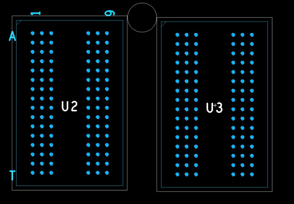

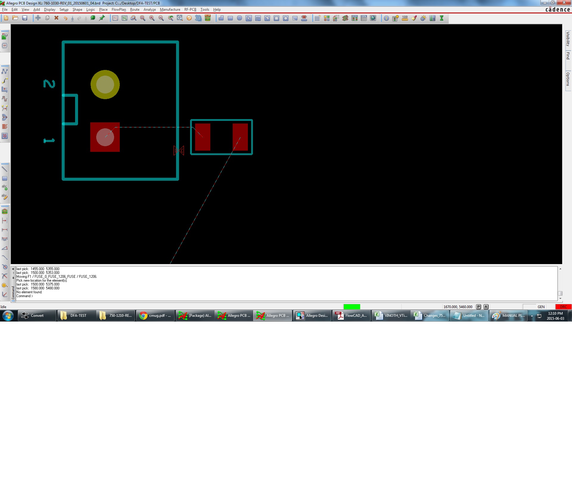

Hi All,
DFA - Design For Assembly.
I have a question. How to view the bubble with DRC in quick placed component ? While moving the components with move option. Is it possible ?

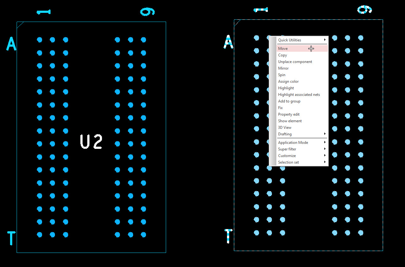

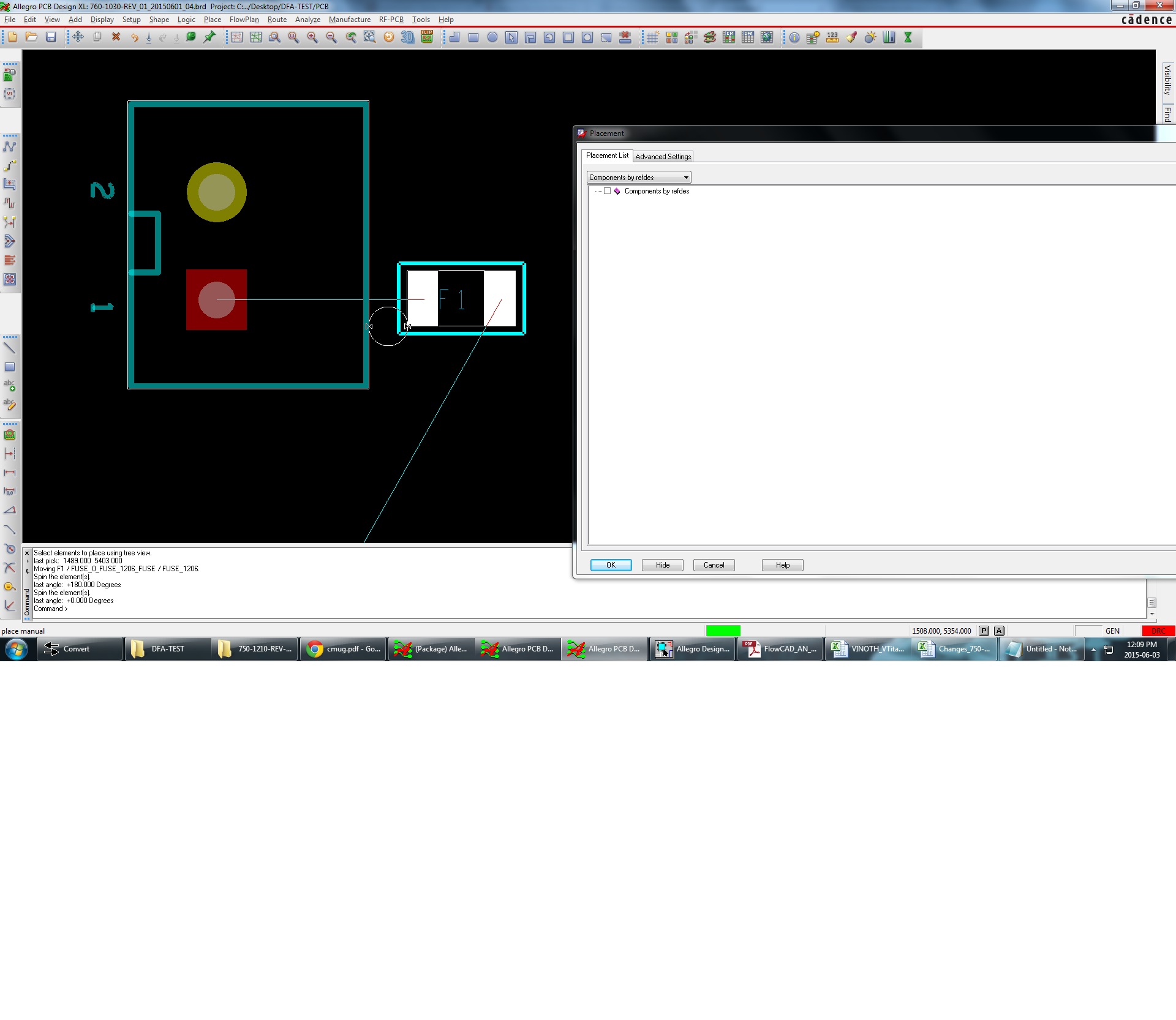

    You need to access Move command via the RMB.  Hover of the Symbol and RMB - Move to move the component
    Once you get to the minimum DFA Clearance you will see the DFA bubbles similar when you are placing the component for the first time.
    Hope this helps,
