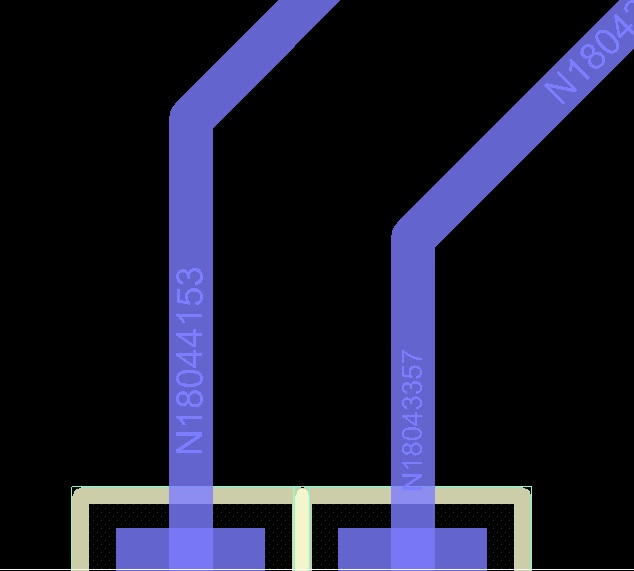

How do i slide and add small vertex at corner of track?
Please help me. it is like inverting the angle of corner. i cannot found such thing in allegro. it happens in layout.

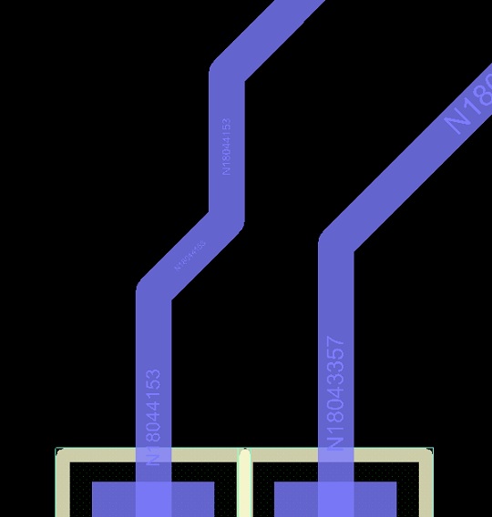

    Try a Slide then right click - Cut and pick the two points of the cut
