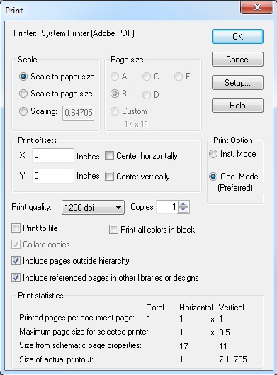

I'm using Orcad 16.5 and have modified an existing (ancient) schematic that had 80 pages.
When I choose "print" from the schematic level, the output only contains one of each of the unique pages and does not contain the full hierarchy of "duplicate" pages.
I haven't been able to find any settings that make a difference.
Has anyone dealt with this issue before? Does anyone have a way to debug this? I really need to print...
This same schematic can be printed by the CAD layout guy who is running 16.6. I hesitate to update as the design is almost done.
Thanks in advance,
Brian
  • Wild
    Wild over 9 years ago
    Do you have the Instance option picked under the Print window?
  • BrianTMcKee
    BrianTMcKee over 9 years ago
    Thanks so much! I had tried Occurance mode before and it didn't work, but I didn't check the "include pages outside hierarchy" so that must have done the trick. I got all 78 pages now!
