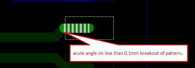

Pad pattern break-out (fan-out) acute angle checking method
elivs
elivs over 9 years ago
Good day!
Anyone here knows any method on checking of acute angles pattern created on smd pin break-out points.
Please refer to the below image.  Please help. Thank you.
  • elivs
    attaching the image.. thank you very much.
  • steve
    steve over 9 years ago
    Yes try enabling the same net spacing rules (Setup - Constraints - Modes - Same Net Spacing) enable the checkboxes then in Constraint Manager - Same Net Spacing tab make sure the Options are set to True, then set the values you want for Pin to Line
