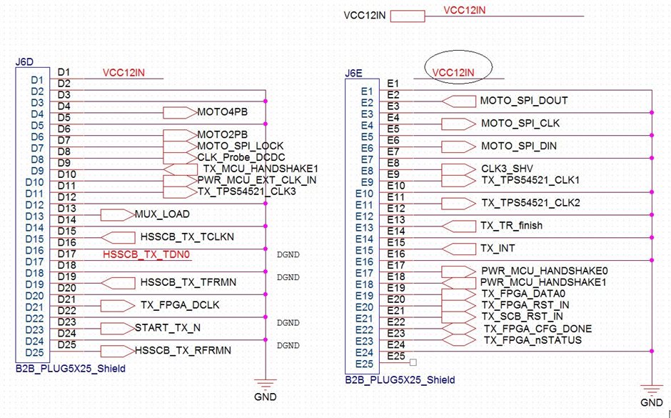

Hi there!
Recently we made a stupid mistake as following picture: the net "VCC12IN"  should connect toJ6E's pinE1 but it's actually "float". The entire J6E was dislocated by one pin space(you could see pin.E25 is empty) . However, the "VCC12IN" I marked with circle is actually not a truely isolated net because it's correctly connetced to J6D's pin.D1. That's why DRC function "check single node nets" is useless here.
Could orcad DRC find this kind of faults in schematic?
Thanks a lot!
  • oldmouldy
    oldmouldy over 10 years ago
    In the Electrical Rules Check, Enable the Run Custom DRC option and Configure the Custom DRC to enable Hanging Wires.

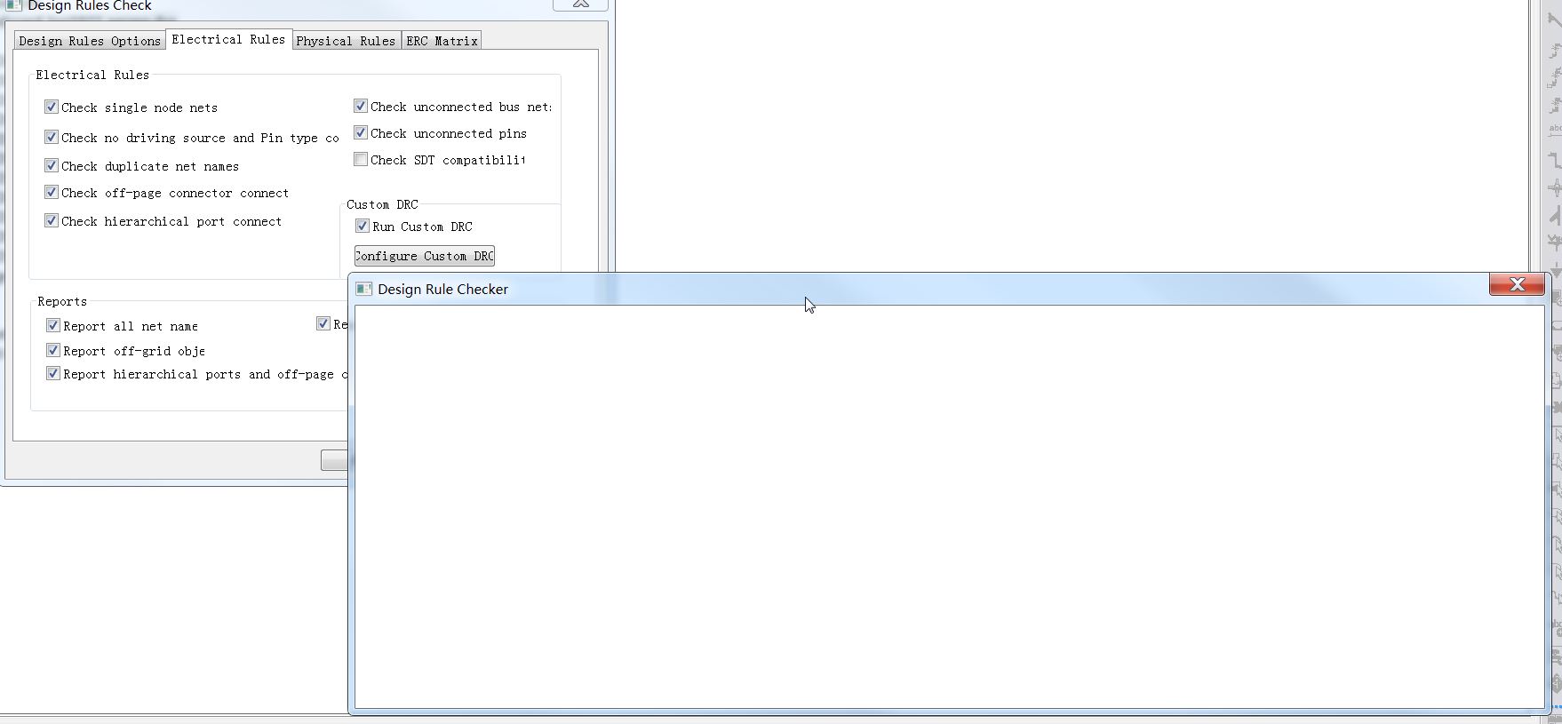

    Thanks for replying. But when I click as you sugguested, the is a blank window in "configure Custom DRC" like this. Is there something wrong?
  • xubuli
    xubuli over 9 years ago
    Does anybody have an answer for the blank window in "configure Custom DRC"?
  • xiaoyi594
    xiaoyi594 over 9 years ago
    You need to install hotfix.
