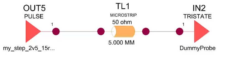

The SigXplorer always displays the length of TL in mils independently of whatever units was it given.
How can it be set to display the length in mm just as in the picture below?
Thanks
  • steve
    steve over 9 years ago
    edit your local env file with a text editor (stored normally in %HOME%\pcbenv folder) and add the following:- set SIGXP_ALTERNATE_UNITS "millimeters X" where X is the number of decimal places.
  • tltoth
    tltoth over 9 years ago
    Thank you steve, it's working fine!
