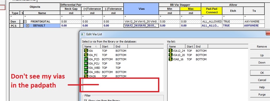

Where can I give the Library path for via in an Allegro design
Hossein1357
Hossein1357 over 10 years ago
When I want to specify via for various Physical CSet in my new design I don't see my own via in the via list. However, I have specified directories for psmpath and padpath. I am wondering if there is a place where I can give the directory.
Thanks,
Hossin
  • steve
    steve over 10 years ago
    padpath is where the all pads/vias are stored so check the padpath setting carefully in Setup - User Preferences - Paths - Library. Make sure you check on the expand button and then add the entries there. If you haven't checked expand then clear the entries and re-add them once expanded.
