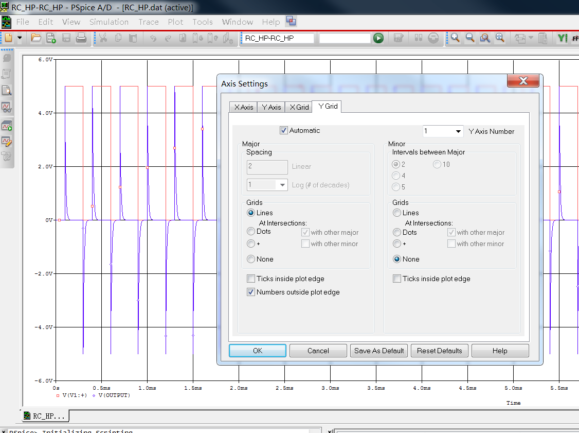

Hi there!
I turn off the X-Grid and Y-Grid in Axis Settings of PSpice A/D. but there are still Grid-lines with large distance, which is not convenient for watching plots sometime.
Is there methode to totally turn off the grids? I just want a pure white or black background.

    Alok Tripathi over 9 years ago
    Select "None" under two grid group section for Major and Minor on both X Grid and Y Grid tab to remove the grid lines seen in image. This will make pure white or black background. Currently Major grid has "Line" as selected option. Thus you see the lines.

    xiaoyi594 over 9 years ago
    Thanks,aklot! Your method works!
