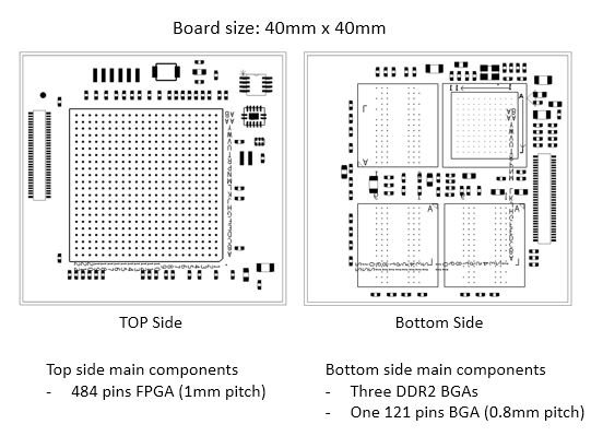

I am designing the PCB for BGAs at double side.
I think that it will need to use HDI PCB.
It is first time to do HDI PCB design.
It is difficult to decide the layers and stackup.
I am considering about the following spec.
- 3 + N + 3 type stackup, 10 ~ 16 layers.
- stacked microvias
Please recommend the the layers and stackup by your experience about HDI PCB design.
