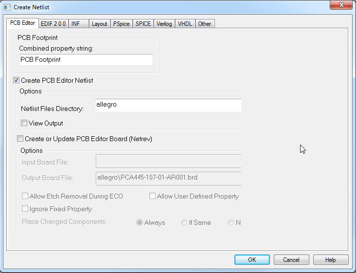

When I click the button to create a netlist from Design Entry CIS, the buttons to select the netlist directory or specify the input and output board files just aren't there.  Even if I expand the window to the right the buttons don't appear as seen in the screen shot below.  This same problem happens in v16.6-S062 and v17.2.  It looks to me like the fonts are bigger than expected causing some stuff to get clipped on the right edge of the window.  Any thoughts on how to fix this?

    You have an issue with the Windows fonts, see this post community.cadence.com/general_topics/f/65/p/24932/1319470#1319470. If you are using Windows 10, you will need to have "Build 1511", or later, since this addressed font issues in the original release.
