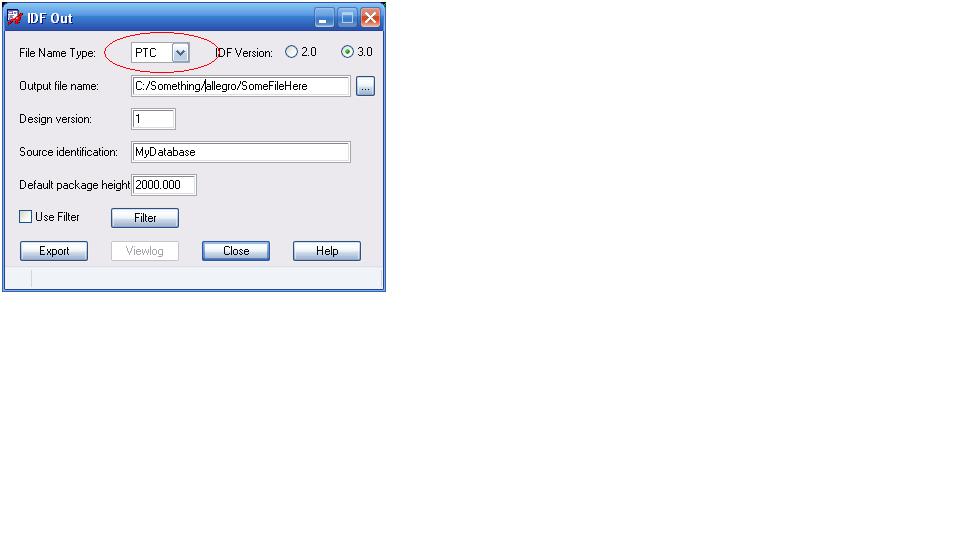

  • redwire
    redwire over 9 years ago
    It is the PTC format (Choose File->Export->IDF, then choose PTC in the pulldown box)
    It is the most requested format that I get for 3D export
