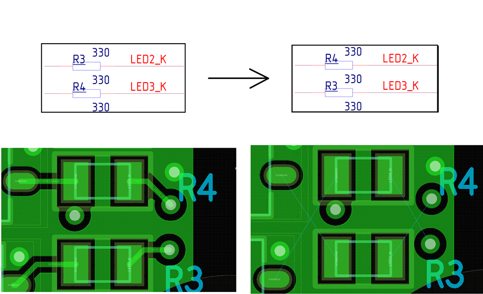

Copy - delete - paste to another page should solve the problem BUT the problem is that I already have routed design. And any refdes changes from CIS after creating netlist and update brd file caused moving connetions and etch removing.
Actually parts are not moving - it moving connections from them - see picture.

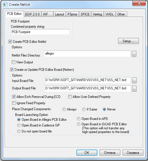

For example i rename  two parts in schematic R3 -> R4 . Then Tools ->  Create netlist (with option of update board file) -> after netrev it open brd file and see that refdes of the part dint change their old places , so all old clines will be lost.

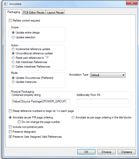

Options->Preferences->Miscellaneous->Preserve reference on copy did not help,  maybe because i have   more than one hierarchical blocks in schematic/
See pictures with changes and settings  below

    I would uncheck the "allow etch removal". This may help or not. If it's just a simple change (like above) you may be OK. If not then once the netlist has been imported, use Place - Swap - Components and manually swap R3 and R4. Ideally once you have completed the board leave the refdes in the circuit as they are. You can always rename the part sin the board design.

    function "allow etch removal" only give old etches to stayed at board, this is not solution - parts are not moving -> routing broken.

    You didn't mention whether, or not, you had run Back Annotation to synchronize the board and schematic before making any schematic changes...
  • juramehanik
    juramehanik over 9 years ago
    Schematic and board are synchronized.

    Here's a little trick I do sometimes (Allegro):
    1. Before I read in the logic (netlist) I copy the component in allegro outside the board area.
    2. I swap the two undefined ref des components with the components I want to replace.
    3. I read n the logic (netlist).
    4. I swap the components with the undefined ref des components.
    5. delete the undefined components.
    Note you must not have the remove etch selected.
