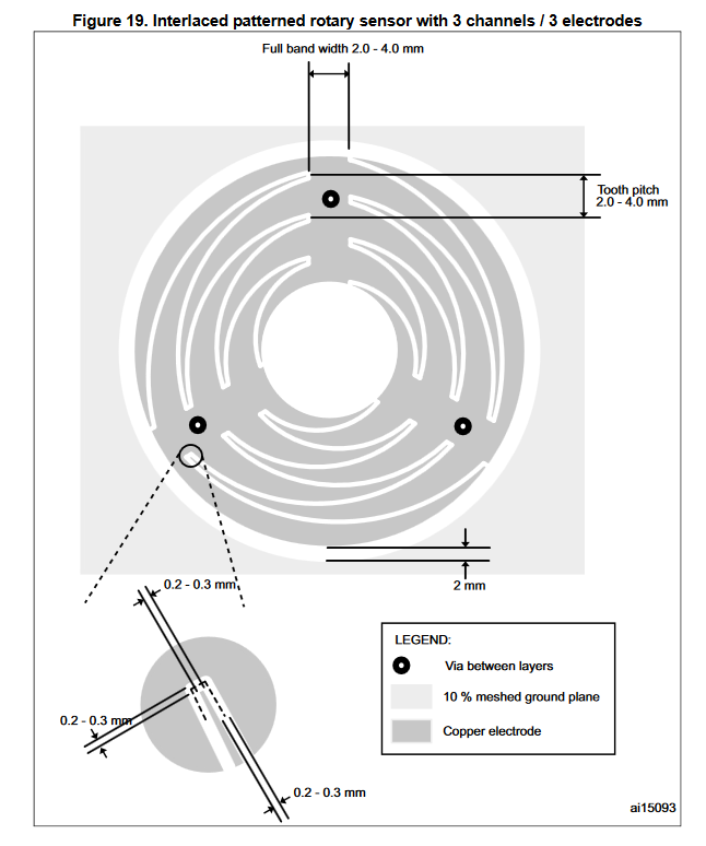

Dears,
In one of my capsense design I need to implement the rotary slider (five segments). How can i recreate the same in PCB editor? Attached is for 3 segments a reference.
Need your valuable inputs,
http://www.st.com/content/ccc/resource/technical/document/application_note/46/39/d6/92/4a/4d/40/9f/DM00087990.pdf/files/DM00087990.pdf/jcr:content/translations/en.DM00087990. (page 24)
Many Thanks

    Looking at the design I do not think it will be possible to create this simply in the PCB editor as it uses a complex copper shape.
    The best thing you can try is to design the pattern using a CAD package like AutoCAD, export a DXF, then import this as a custom copper area. This should get the gaps and shape correct for a reliable footprint.

    It looks like 3 exactly the same shapes.
    With this assumption, the way I would approach this issue:
    1 Create a shape in Solidworks (sorry if you don't have) or Auto CAD.
    2. Export  shape as a DXF
    3. Import into Allegro as a shape symbol
    4. Create a pad using the shape from shape symbol save.
    5. Create a new footprint from the pad.
    This is where you can rotate and add a via.
    Good luck.
