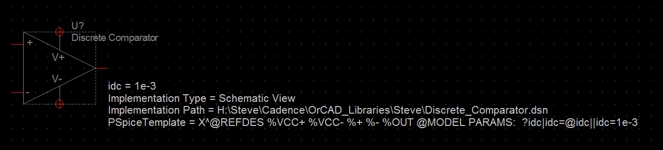

I'm having trouble passing a parameter value to a hierarchical schematic part.  Here are the details:
1. I created a library part with this PSpice Template definition: X^@REFDES %VCC+ %VCC- %+ %- %OUT @MODEL PARAMS:  ?IDC|IDC=@IDC||IDC=1e-3|
2. In the library part I added a parameter called IDC, also with a default value of 1e-3

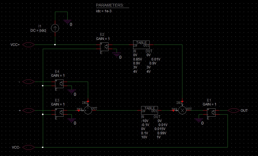

3. Then I created a hierarchical part with a schematic that has a DC current source value that I set to {IDC}
The problem is that unless I add to the hierarchical part schematic a PARAM block with a parameter called IDC and a value, my simulation of a design using the hierarchical part won't run (can't identify IDC parameter).  But when I do add the PARAM block to the hierarchical part schematic, its value overrides the one in my simulation design schematic.

    Perhaps I'm being thick, but I think something is getting lost in my poor description of what I'm doing. Perhaps some screen shots will help. So, first I created a PSpice library part as follows (I've shown some of the part properties for clarity, even though I'll turn off their visibility normally):

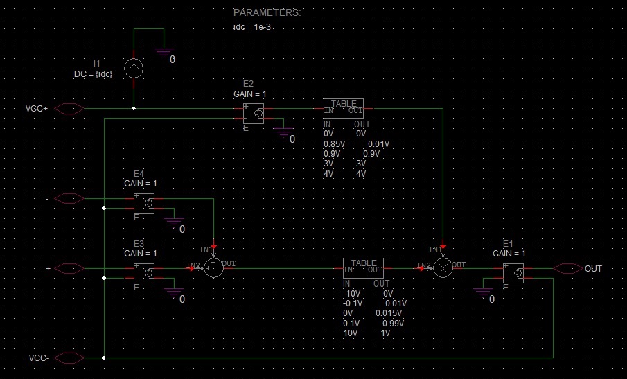

    As you can see by the Implementation Type this hierarchical part is then attached to a schematic where the parameter 'idc' is used as the DC value for a current source. Notice the PARAM block - until I added this to the schematic, I would get an "Undefined parameter: idc" error during netlisting.

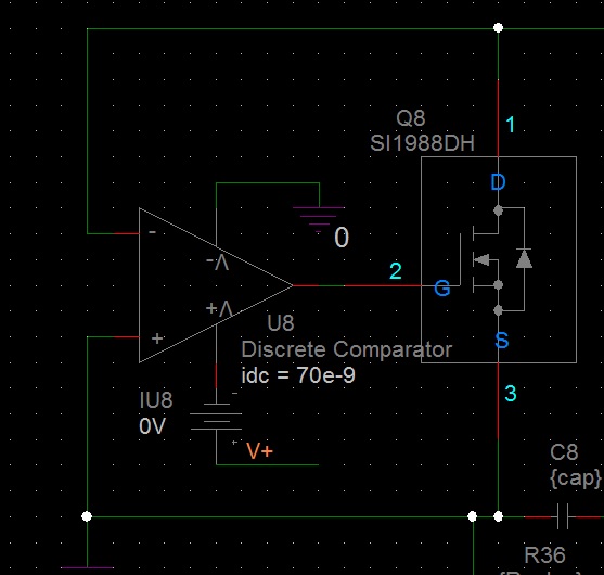

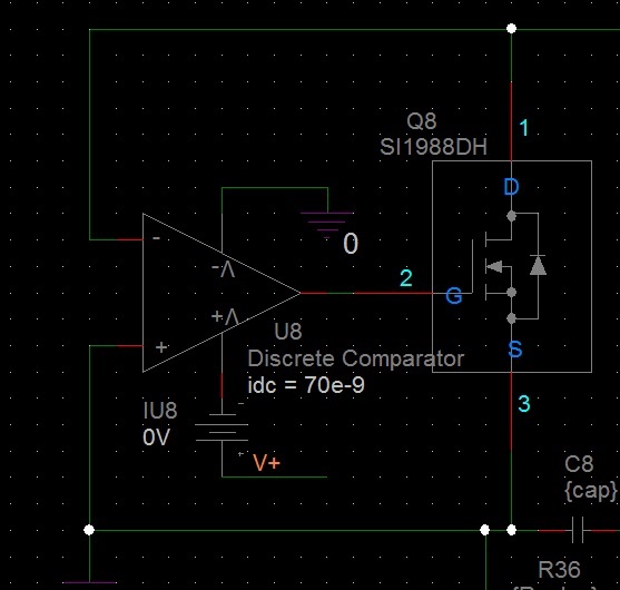

    Finally, I placed the library part in one of my simulation design schematics and set 'idc' to a value different than the 1e-3 default:
    Of course the value in the PARAM block is used, not the value I want to be passed from the design schematic (70e-9).
    So what am I doing wrong?

    OK, see what you mean now! Your "comparator part" doesn't need a PSpiceTemplate property, the Part gets "connected" to the underlying schematic by Pin Name / Port Name matching so no "template" mapping required. Your part also needs Primitive set to No (you probably already have that) and the IDC property and to be visible for ease of editing, also as you have it. No need for the PARAM part in the underlying schematic, that's a Global Parameter, replace that with a "SUBPARAM" part, add an IDC property and a default value to the subparam and change the DC={IDC} to be DC=@IDC for I1. I admit that my need has always been to override the Subparam default value so you may find that you need to specify IDC on the part in the upper schematic but "no value" of IDC could get the Subparam value active.
