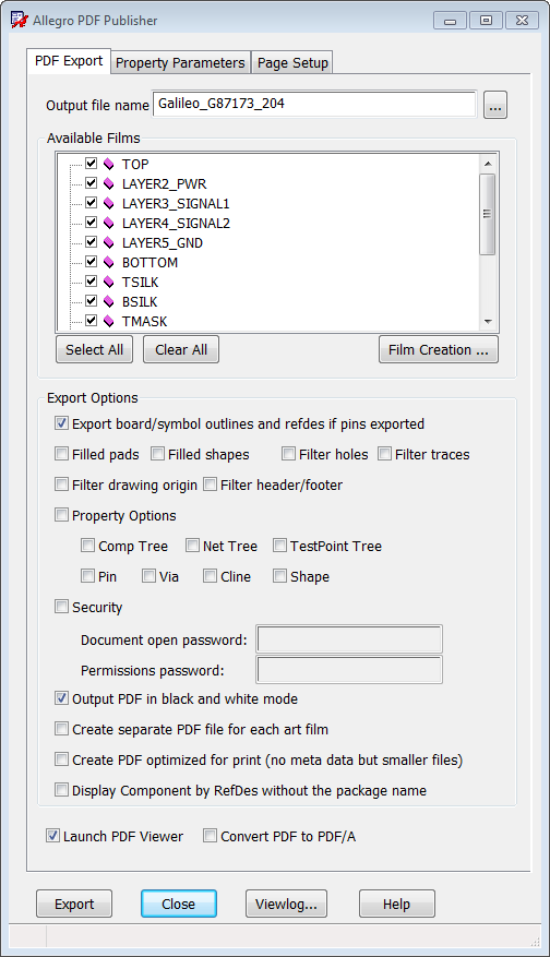

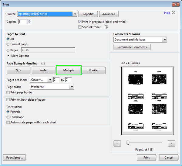

    There is a couple ways to accomplish what you are looking for but I would recommend exporting a PDF file of the layers and use the Print option in Adobe Reader to control how many layers are placed on one page.
    The PDF Export uses the Artwork Film Records, which is required for manufacturing output, so it is pretty simple to generate a PDF file of all the layers quickly at the end of the project.
    Before outputting the PDF File the Film Records would need to be reviewed to ensure the PDF Sequence on each Film Record correctly define the page order of the PDF Export.
    For your mirror print requirement, the Film Record has an option "Film mirrored" to mirror the output, you could temporarily enable on any Film Record you like when creating the PDF file BUT you must remember to disable it before output manufacturing data. (Suggest saving the design first, making the adjust the "Film mirrored" option, export the PDF File and do not save the design)
    File > Export > PDF or Export > PDF or type command pdf out
    Allegro PDF Publisher dialog will show the Available Films based on the PDF Sequence, select the films you want to output, make any settings adjustments and click Export.
