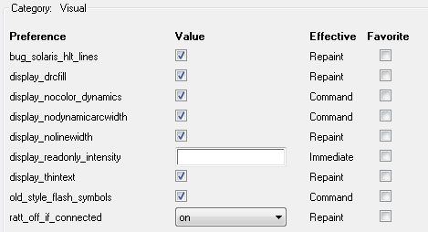

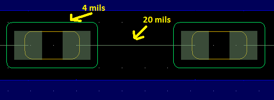

I'm designing PCB in Allegro version 16.3. I set the line width as 20 mils for routing nets, however, the width of 20 mils lines display same as other (for example 4 mils line in the below image).
I copy my design to other laptop, it is ok, the 20 mils lines looks wider than 4 mils lines.
Could someone help me to address this problem?

    Thank you so much. I uncheck this variable and i can see the true line widths. I did not know why all variables were checked @@
