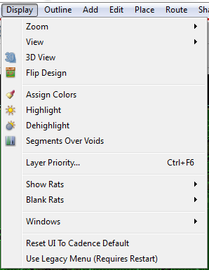

    Too bad it needs to be done on a design by design basis... but I can't get it to work there either. My options under design when I've got a .dra open are:
    But when I've got a .brd "Property": isn't there:
    Does this mean that my allegro.cfg isn't found?
  • redwire
    redwire over 8 years ago
    Any way you can post up a board with the symbol and associated netlist?  I try this on my system and it works fine.  I can display the custom properties added by the netlist just fine.
