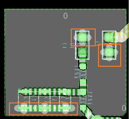

Hello I have these Unrouted connections. These are all the 0 (or gnd) pin of various components an I will connect all these to the Ground (I will have a ground plane - Dynamic copper on the top).
Is there any actual problem occurring from this situation? I mean, I intend to ignore these warnings. Will the final gerber files have any malfunctioning? Will this affect production?
Also I did not find anything relative to this in the Documentation - maybe I did not search deep enough, any point where I should look?
-> Allegro ver.17.2
Thanks alot!
Andreas

    It sounds like your PCB is not fully routed so the report you see is to be expected. You can generate gerber files anytime regardless if the pcb is fully routed or not.
    When your PCB is complete re-run the status. If you see "Unrouted Connections" this means you have nets not connected. Proceeding to create a finished pcb will mean your board will come back with floating pins !
    Not good. "Don't ignore any warnings" Check a few times before going to fab. Also run a check on the gerber files !
    All the best
    Paul.

    Actually, the design and routing is completed. What remains is the use of  fanout  for all my unconnected nets and connections-all of those remaining must connect to the ground plane (top layer) as the one that follows:
    To my understanding from all I have read in the  Allegro® User Guide: Routing the Design  (c:/Cadence/SPB/doc/algroroute/chap2.html#1035250) - Ch.2-Component Fanout,
    So the question is: is creating FANOUT for all thes component pins actually required for the proper finalizing of the design? Should I perform any other step?
    Thanks again!
    Andreas

    Fanout is typically used to fanout multi pin BGA components so as to aid in routing. Fanout is not required in any design, you don't have to use it. The only requirement of a design is if a net exists then that net is connected.
    Since you have a ground plane on the top layer you can either re-pour the ground plane again and it should automatically connect to your components ground nets, assuming you gave the ground plane a net of ground.
    The other option is to manually route each ground connection from a component pin to the ground plane. "Run DRC Checks" when your board is complete !

    I used Shape Add-> [Etch=Top, Type=Dynamic copper, Assign net name=0] and the output is as follows:
    It seems that as expected all 0V (GND) Pin of all Symbols are actually connected automatically to the Ground Plane. Only DRC remains.
