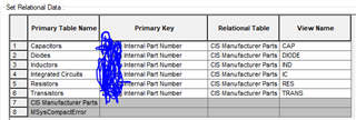

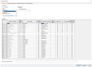

I am able to open CIS explorer to see folders which were pulled from from My Access Database but I have the following errors that appear:
ODBC Error Description: State:07001,Native:-3010,Origin:[Microsoft][ODBC Microsoft Access Driver]
ERROR(ORCIS-6245): Database Operation Failed
Please Check Session For More Details
ERROR(ORCIS-6250): ODBC Error Code: -1
Description: Too few parameters. Expected 2.
Both the 6245 one as well as 6250 one appears when I move from one Access table to the next in CIS explorer.  No information appears when I try to show part information which is supposed to be contained in the relevant folder.
I'm not sure if the reason these errors are coming up are due to Drivers or a a corrupt ODBC datasource or if they are Bad column Names in the Microsoft Access file for some of my different tables?
Could be any number of things.
The database name was "COTS Database" shown added as an ODBC datasource in screen 2.

    OK Mac helped me and I'm going to describe what he did to fix my Microsoft Access Database in the event it helps someone else in the future who is trying to setup their ODBC database for their organization.
    My Access database had some illegal field symbols that was causing the error I had specifically "?"   The reason I had that symbol was because I put in some fields for my organization that I wasn't sure If I truly wanted to implement or not.  That was causing the error screens shown in the pictures above.
    Make sure you do not use "?" or any Illegal symbols as any "field" or "table" names in Microsoft Access because it craps out when you are creating your XXXXX.DBC file in Orcad CIS.
    Orcad doesn't want to see a "?" character as a field name.
    Also make sure the Access database file is in     XXXXX.MDB format when you link it as a source.
    Also use the wizard if you understand it, Its asking to match parameters 2 at a time on each screen.
