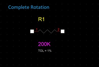

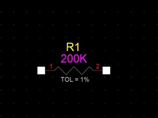

Next up is symbol rotation at the schematic level. When I rotate a symbol through 90 degrees the symbols attributes go all over the place. This thing cant even put the attributes back in the correct place going right through 360 degrees. I was wondering is there a switch or something to keep things lined up. I don't relish the idea of having to create both horizontal and vertical symbols, perhaps there is an easier way ?

    SelectFootprint.zipSo the best thing to look at is the CIS option. All the properties are stored in a Windows Compliant ODBC database (like MS Access or SQL) and so no manual editing to add properties. If you consider this I would also consider CIP to help you manage this. If engineers make changes to properties on parts there is Part Manager which can compare the schematic contents with the database contents to ensure they are using the approved properties and not user defined ones. For the rotation you can consider the Convert Part option so you have a 2 symbols defined with properties placed where you want them if you to control the property location "tighter" than the defaults.

    If you look in the Accessories menu the Cadence Toolkit > Utilities brings up the Tcl/Tk Dashboard. The last choice on the list is Help on Scripting and that opens the OrCAD_Capture_TclTk_Extensions.pdf file.
    Page 66 seems to describe a solution to your rotation problem.

    Hi Steve & Joma thanks for the help and advice on my questions. Per Joma's suggestion I took a look at the TCL command and indeed the following TCL command resolves the rotation issue.
    SetOptionBool RotateInstPropInContext TRUE
    It works good, better than default in capture.
