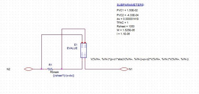

I have implemented a non-linear resistor via a heirarchical block using analog behavioral modelling. I added a subparam property named Rsheet which affects the resistance.
I have simulated this nonlinear resistor hierarchy block and it works  perfectly well. However, I need to use multiple copies of this , each with a different subparam  Rsheet value. I tried copying the hierarchy block then pasting it mutiple times. The problem is that changing the Rsheet value for each copy does not work. I have verified by pspice simulation that each block still uses the Rsheet subparam setting of the original hierarchical block because each block behaves exactly the same.
I noticed that the resistor and VCVS(E) have the same reference, R1 and E1 for all copies. So i read this thread: https://community.cadence.com/cadence_technology_forums/f/pcb-design/13224/how-to-reuse-the-hierarchical-block  and followed the instructions of  User:oldmouldy. I went to tools>annotation and selected unconditional reference update.  (I used update occurrences instead of instances). After doing these, the references changed to R1, R2... and E1, E2.. However, the subparam still has the same reference=1 for all copies. Changing the rsheet subparam value for each copy still doesn't work. In fact, even if the references of R and E are now correct, and even when setting R1=1k and R2=2k and removing the VCVS, both blocks still behave exactly like the 1k resistor. It's like  the copies use the original setting despite all editing I've done in the properties and annotation.
My workaround was to create an entirely new schematic just for the same circuit with a slightly different parameter and it now works perfectly. But I really want to be able to edit the subparams of each hierarchy block copy independent from each other. Thanks. Any help will be greatly appreciated.

    For the hierarchy, add properties to the Hierarchical Block that match the names of the sub-parameters that you want to change, the Hierarchical Blocks can be copied and pasted and the then the property values can be changed for each Hierarchical Block instance.
    There are limited parameters available for the Resistor model, one is the Resistance Multiplier and the other 7 are related to temperature, similarly, the Capacitor model has 6 temperature related parameters and 2 voltage related parameters, which restricts "what" can be changed from the fundamental model parameters for those component types.

    Thanks for the response. It's working now
