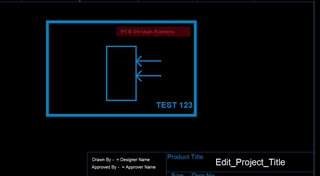

  • excellon1
    excellon1 over 7 years ago
    Hi maybe try this.
    In capture you can create TitleBlocks, these wont package and can contain graphic elements.
    Open a symbol library of your choice and create a new symbol. Choose the symbol type to be a title block and give it a name. Draw your shapes etc, you can even add pictures to it. Save out your new title block.
    Back in your capture schematic on the tool bar choose place title block. Use the dialogs to point to the library  that contains your title block. Place it on your schematic.
    Here is an example.
    So you can see the new title block on the schematic page.
