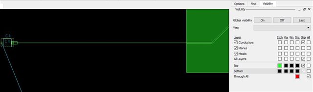

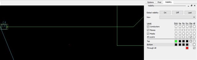

    I have attached screenshots for your refrence, just to make sure if I am doing the steps right.
    near Capacitor C4 there is a small static shape. that will turn-off, but for dynamic copper the outline remains. What might be the issue?

    chadga over 7 years ago in reply to steve
    Yes Steve. I tried the same steps, it's still the same.

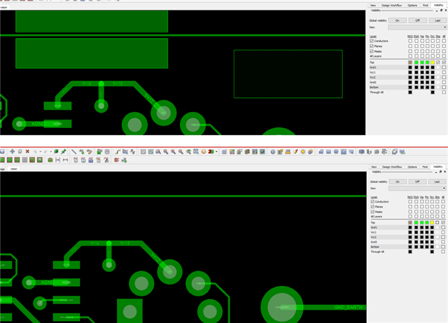

    What hotfix are you using? I'm running 17.2-2016 S049 and it just works. The shapes at the top are dynamic and the on below the cline to the right is static.
  • chadga
    I am using the same hotfix version S049. I think I got it, i tried turining off the boundary in color dialog box and it worked.
    Thanks for the quick response.
