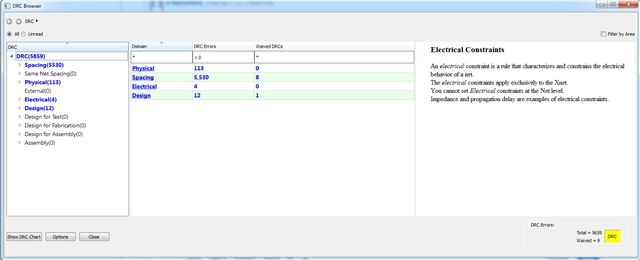

    Hey Robert, thanks for taking the time to help me out here, I appreciate it.  Let me fill you in on the newest info.   So, when I open even the original board (no changes by me) and run a DRC update.   All of the problems I was seeing before are present(maybe even more, there's almost 6000!)   So what does this mean?   Did the original board contain all of these errors?    It's not letting me export a gerber because of these, so how was it done before?   I'm too new at this, I have no idea what to do.

    Without seeing your board and based upon what I'm reading. I can only assume that you have little tiny disconnects everywhere. Not DRC violations unless things shifted around so badly that everything is banging together. Did you try adjusting the design's "Accuracy" settings? If the older footprint had graphics parked out to let say-.0001 and the new database was set at .001 (3 place accuracy). During the part swap out on your new layout. OrCAD would have moved those graphics to a .001 location based upon your settings. Thus the graphics shifted.  Why your design screwed up everywhere is stranged.
    Now, let's say you have only a bunch of tiny de-connect. To speed up re-connecting everything try the following- 1. in the color dialog box select "global visibility'   to off. Then hit ok. 2. while in the route mode, window select all the dis-connected traces then right click and hit "finish". Everything track should connect. The changes if any should be so small that it will be something you can live with.

    While I could be wrong, these are showing up as DRC errors.
    But I really like what you've suggested, and I would like to try it.   Where would I go about finding the accuracy setting?
    What really has me interested is this "finish" button that will autocomplete broken connections.  I don't seem to have this option when I right click.   Is it in all versions?
    Now here's the funny part, the browser i took the screenshot of, is from the ORIGINAL file(before I made any changes).   They weren't showing up by default, so I didn't even know they were there.   Maybe changes made in newer versions of orcad caused changes?   The good news I guess is that I didn't create these problems(my file only has 5527 errors) , but obviously the board works, because I work with them every day.   How was this file able to be exported with all of these errors?   I can generate art files, but no gerber.

    You can also use Tools - Derive Connectivity to resolve these small unconnects....
