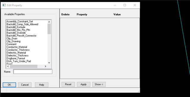

I'm attempting to rename a selected set of components prior to back annotation. I can't manage to add the required AUTO_RENAME property to the components to do so. Based on the help file my understanding is that there should be an AUTO_RENAME property in the drop down.
I attempted to pass this property in from the schematic with no success.
Result of attempting to rename selected components without the property: "No components wth AUTO RENAME property found on subclass TOP and BOTTOM. "
  • markee
    markee over 6 years ago
    As soon as used: Find -> Find By Name -> Device Type: to select by device type the field was populated correctly.
    Mark
