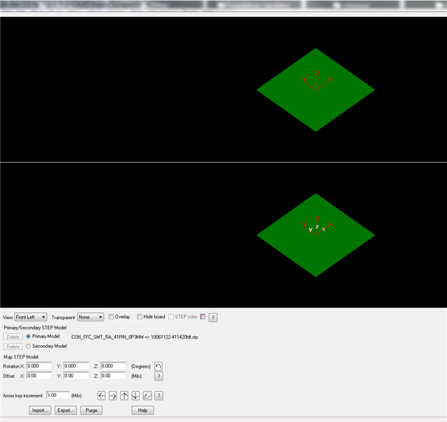

I am trying to assign a particular STEP file to a footprint in the STEP Mapping tool.  When I do, it shows as blank.  I note that the STEP file is significantly larger than most, but I don't know if that is affecting my issue.  I've got many other STEP files that I've downloaded from various sources, but only this one gives me trouble.  OrCAD v17.2-2016 S055.  Thoughts?
Note: I saw here that someone tried changing the design units, but that didn't help me.
Amphenol ICC 10061122-411420HLF

    I have had that problem also. I took the model into Creo and re-exported it to correct the problem.

    melview1 over 6 years ago in reply to eDave
    You're amazing!  Thank you very much, that worked.
