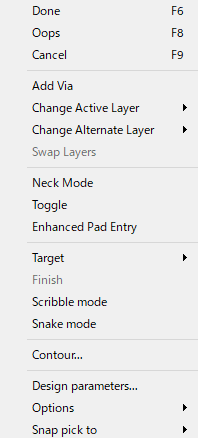

i do not know how other people are dealing with this.
the commands like "connect" and "assign color" can be ended by pressing F6 (Done).
but the commands like "net logic" can not be ended by F6.
is there any way i can end all commands by press F6?

    F6 key is not working on the net logic command.
    the connect command has the menu on RMB which shows F6
    however the net logic command has no function key like F6 shown on RMB menu.
    is there something wrong with the setting on my allegro?

    it works but...
    it works when i use the net logic command from the top menu.
    but i created a short cut on the env file as follow
    funckey 2 "net logic"
    when i use this function by pressing Key 2, F6 is not working.

    I was able to see what you are seeing.  Interesting it only occurs when using a funckey for certain commands.  This looks like a bug.
    I did find a workaround so the function key works, you will need to disable the command history window.
    Setup > User Preferences > UI > General and uncheck the box next to enable_command_window_history and restart the tool.

    wow, it works now.
    thank you, mcatramb91.
