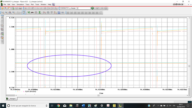

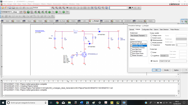

Hi community,
I designed a DC/DC boost converter with a RLD snubber. I ran a parametric sweep to study how the snubber inductor influences the reverse recovery current of the main diode. I chose different inductance values but at the end of the simulation, I noticed a weird behaviour highligthed in the picture below. In particular the tool shows  other values of inductance of a previous simulation, even if I run again the simulation deleting these values, PSpice still continues to show them without evaluating their waveform. Maybe I was mistaken with the settings of the simulation, I am not sure. Could someone help me to undestand how to fix this issue?
Thank you in advance,
Gerry
The figure below shows the issue I talked before.
  • oldmouldy
    oldmouldy over 6 years ago
    You don't say which version you are running. I checked this out with 17.2-2016.s057 and I am not seeing any issues like this so, it could be possible that the problem is related to the exact version of PSpice that you are using.
  • Gerry95
    Gerry95 over 6 years ago in reply to oldmouldy
    The version I am using is 16.6
  • oldmouldy
    oldmouldy over 6 years ago in reply to Gerry95
    It's also fine for me with 16.6-2016.s112. There were 113 versions of 16.6 between the Base Release and the last hotfix that was issued. As I previously mentioned, it could be possible that the problem is related to the exact version of PSpice that you are running.
