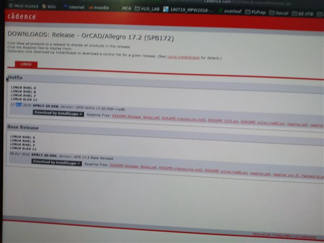

  • VijayKK
    VijayKK over 5 years ago in reply to VijayKK
    As suggested i have updated to S058, but still i am not able to get the Eagle translator.
  • VijayKK
    VijayKK over 5 years ago in reply to jc teyssier
    I have dowloaded the latest versio S058
