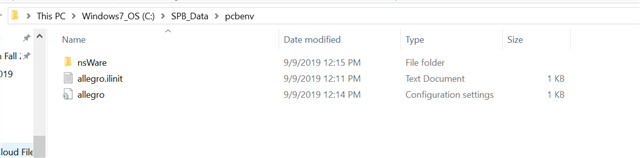

  • Decaf
    Decaf over 6 years ago in reply to excellon1
    Thanks for the advice. I'm still having some issues. When I uninstalled and reinstalled, it actually still used the appdata/roaming/blahblahblah directory that I showed before when i rebooted. To mitigate this, I deleted the directory and also deleted my Cadence directory in C: . I then uninstalled an reinstalled the program again, and it created the directory you mentioned. When I first start PCB lite, I see now using the set command where my localenv and home are. I also see that .jrl files were created upon startup of PCB editor lite for the first time in the home directory below. This is all perfectly fine.
    set home = C:/SPB_Data
    set localenv = C:/SPB_Data/pcbenv
    However I still can't get those print statements at startup to show, which is currently my main concern because if the print statements don't show, then the commands clearly aren't being called so nsware will naturally not be called either. Here's an image of my new directory. where allegro.ilinit resides.
    And here's what's in the .txt file. I've removed the loading of nsware because I can't even get the allegro.ilinit to work properly so I should eliminate that step in the debugging process first:
    printf"Start Loading Skill files:"
    Note that if I type the above command straight into the command line, it says the following. Should I be concerned by this? Or does it simply have to do with the fact that skill files can only be ran at startup in the lite version.
    E- Command not found: printfStart Loading Skill files:

  • steve
    steve over 6 years ago in reply to steve
    just also noticed that the first line is missing () which may stop all of it working try replacing printf"Start Loading Skill files:" with printf("Start Loading Skill files:")

  • steve
    steve over 6 years ago in reply to excellon1
    This just works for me. The pdf that is part of the zip file contains all the instructions, Put the contents into a folder say C:\SPB_Data\nsWare) then in your allegro.ilinit file add the line load ("C:/SPB_Data/nsWare/ns_planar.il" "nsWare"), add a return, then save the file. Make sure you add the "nsWare" at the back which is the password for the skill to run then restart PCB Editor and type ns_planar at the command line in PCB Editor to start the app). The instructions are very clear.
