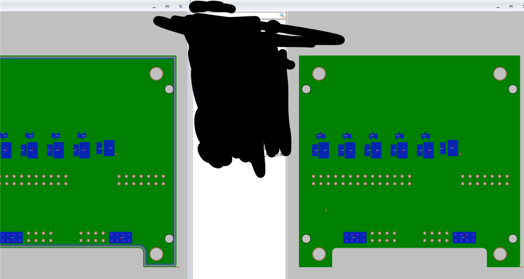

I try to setup a collaboration between ECAD and MCAD. So far it works but the big problem is, that all parts on the back side (only on the back side) are twisted (180°).
If I export the PCB as a IDF, everything is fine. If I export this as IDX everything is twisted.
Is there an option so I can turn this off/on?
Thanks
Left pic: IDF export=right see coordinates
right pic: IDX export=wrong
ORCAD 17.2
Solidworks 2017 /  CircuitWorks

    I have seen this problem with step files on earlier 17.2 releases as well. Make sure you are running one of the latest hot fixes. I not sure which one fixed the problem that I had. But, was corrected.

    Im running 17.2-2016 S049. Also tried to export on the 16.6 S069. Still the same issue

    IIRC there is an option in the Circuitworks settings for correcting the reversed bottom side parts.  I use IDF only with CWX and don't see any issues with this.  I suspect that option is to deal with the case you are seeing.

    YES youre right. Thanks
    I found this setting in ProStep EDMD. Somehow Ive been searching for this option in the IDF-import.
