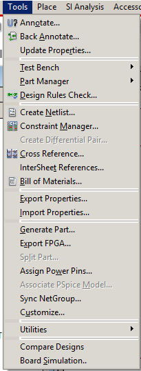

Create Differential Pair grayed out in OrCAD Capture
Fredda
Fredda over 6 years ago
I have a number of differential pairs in my design, which are created in Capture from Tools->Create Differential Pair. I was going to create another pair and noticed that the menu item is suddenly grayed out.
When looking into the Constraint Manager I could also see that the pairs I had created earlier were "broken". All I know is that I was flipping a CM choke in the pair and adding some new net names.
DP1+ and DP1- were originally a diff pair. I then flipped the choke (1 <-> 4 and 2<->3) and added the DP1_CM+ and DP1_CM- net names. Well, something like that. Anyhow, in the Constraint Manager I can see that DP1+ and DP1_CM+ are now suddenly defined as a pair. What is going on here??
