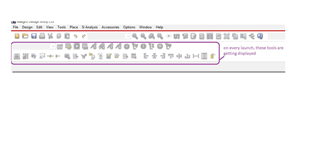

Hello Team,
Whenever I launch ORCAD, I see unwanted tools being enabled like pSpice, Alignment, etc. which is not required for my current task. I tried to disable this using customize option but on re-launch, the earlier disabled tools are appearing back.
How can I disable this permanently (at-least till my current task is completed)?
 I’m trying to disable this to get wider screen for my design aspects.
With Regards,
Shiva.
  • CadAce2K
    CadAce2K over 5 years ago
    VIEW/Customize/Toolbar
  • appi
    appi over 5 years ago in reply to CadAce2K
    But on re-launching of the tool, those options will again re-appear
  • steve
    steve over 5 years ago in reply to appi
    So there was an issue with this on an earlier version, get the latest hotfix from support.cadence.com or download manager and this will work. 17.2-2016 S060 is the latest
