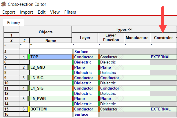

    To make it easy you can assign a Layer Sub-Type in the Cross Section Editor to create a sub-group in Constraint Manager for rule assignment.
    Finally, create separate Net Classes for GND nets and NETA nets then assign the newly created Spacing CSet when the Classes come in contact with each other to drive the larger Shape to Line Spacing
    Here are the steps:
    1. In the Cross Section Editor, enter External under the Constraint column for Top and Bottom

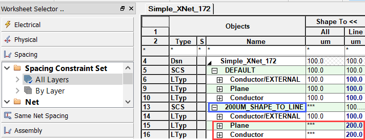

    2. In Constraint Manager > Spacing Constraint Set > All Layers
      • Update Default Spacing CSet so it has 100um for Shape to Line
      • Create new Spacing CSet "200UM_SHAPE_TO_LINE" (RMB > Create > Spacing CSet over DEFAULT)
      • In Spacing CSet "200UM_SHAPE_TO_LINE", enter 200um for Shape to Line on Conductor and Plane Layer Types and 100um on Conductor/EXTERNAL Layer Type

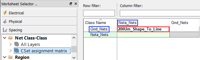

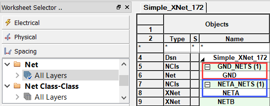

    3. In Constraint Manager > Net > All Layers
      • Add GND to a Net Class called "GND_NETS" (RMB > Create > Class over GND)
      • Add NETA to a Net Class called "NETA_NETS" (RMB > Create > Class over NETA)
    4. In Constraint Manager > Net Class-Class > CSet assignment matrix
      • Assign "200UM_SHAPE_TO_LINE" when Net Class "GND_NETS" comes in contact with Net Class "NETA_NETS"
