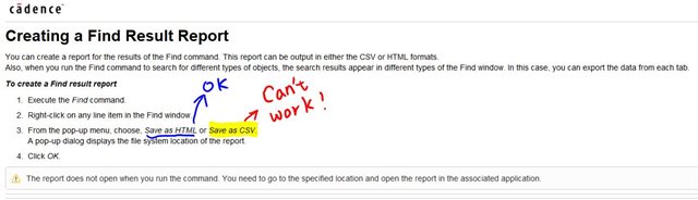

(OrCAD version is 16.6)
Hi, there.
I'd like to create a find result report as CSV File, but it can't work.
After choosing 'Save as CSV' is nothing happened on OrCAD.
BTW, creating a find result report as HTML File is OK.
Has anyone solved the same problem before? I'm looking forward to your help.

    Could be the exact version that you are running. This works fine with the last version of OrCAD Capture, marked 16.6.s086.

    My version is 16.6-S086 (v16-6-112HJ), and some of my colleagues also have the same problem.
    We try to figure out the issue, but failed. Thank you, Oldmouldy.
